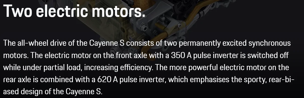

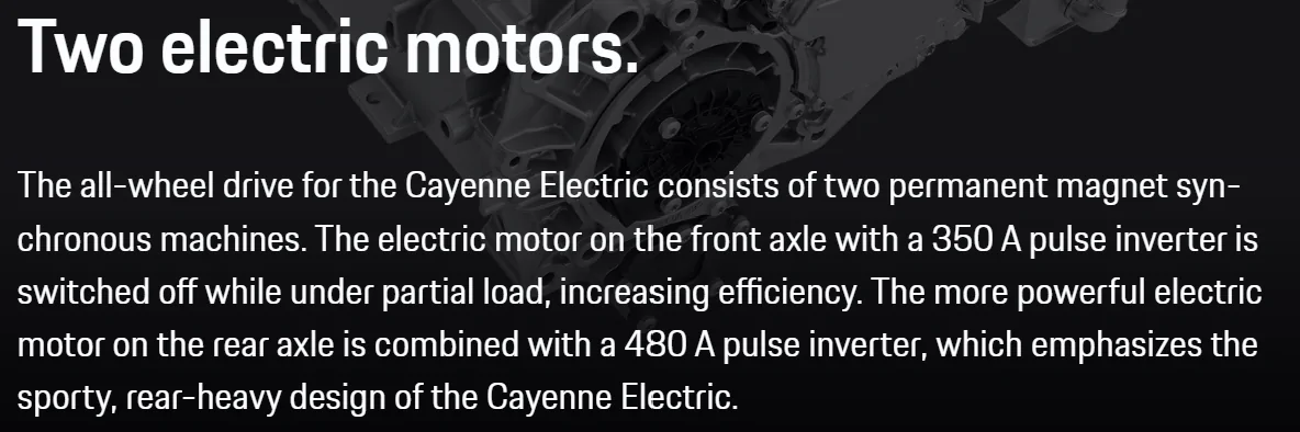

S and Turbo list PMSM front and rear while the base only lists PMSM on rear without any mention of a front motor of any type. I thought the base used Macan S motors front and rear which are both PMSM. Is the base front motor an induction motor?
S has 400mm front discs whereas the base has 375mm discs.
In the USA the S weighs 91 lb more than base model. That seems like a lot for the slightly larger rear motor and bigger front discs.

Seems about right. Oil cooling, larger engine and inverter. Don't forget, the rear axel layout maybe different too (like base Macans couldn't have RAS).
