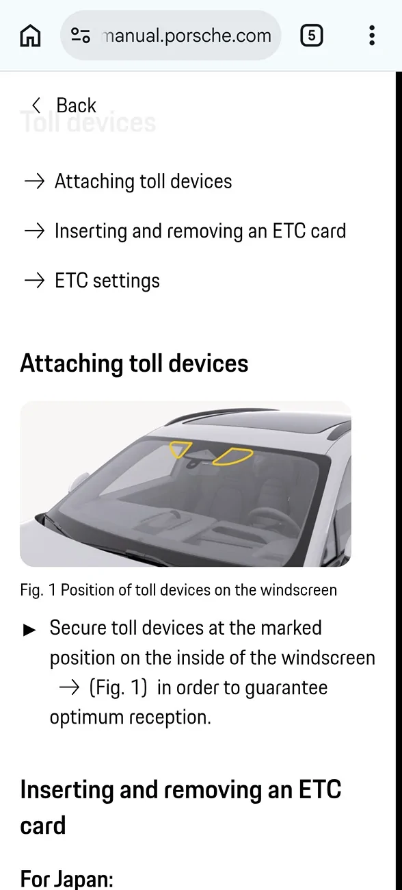

Any experience with interruption to mobile phone network whilst in the car with the thermal windows closed?
For toll devices recommended position is as per diagram.
Pretty sure your phone will be fine also but odd what the dealer has advised you - do they have a clear explanation as most would positively encourage it.

Thank you! He just said he doesn’t k ow much about it and checked the macan evs they have on the floor and none of them have it so I was advised it’s not a popular option in aus and is mainly for extreme weather locations.
