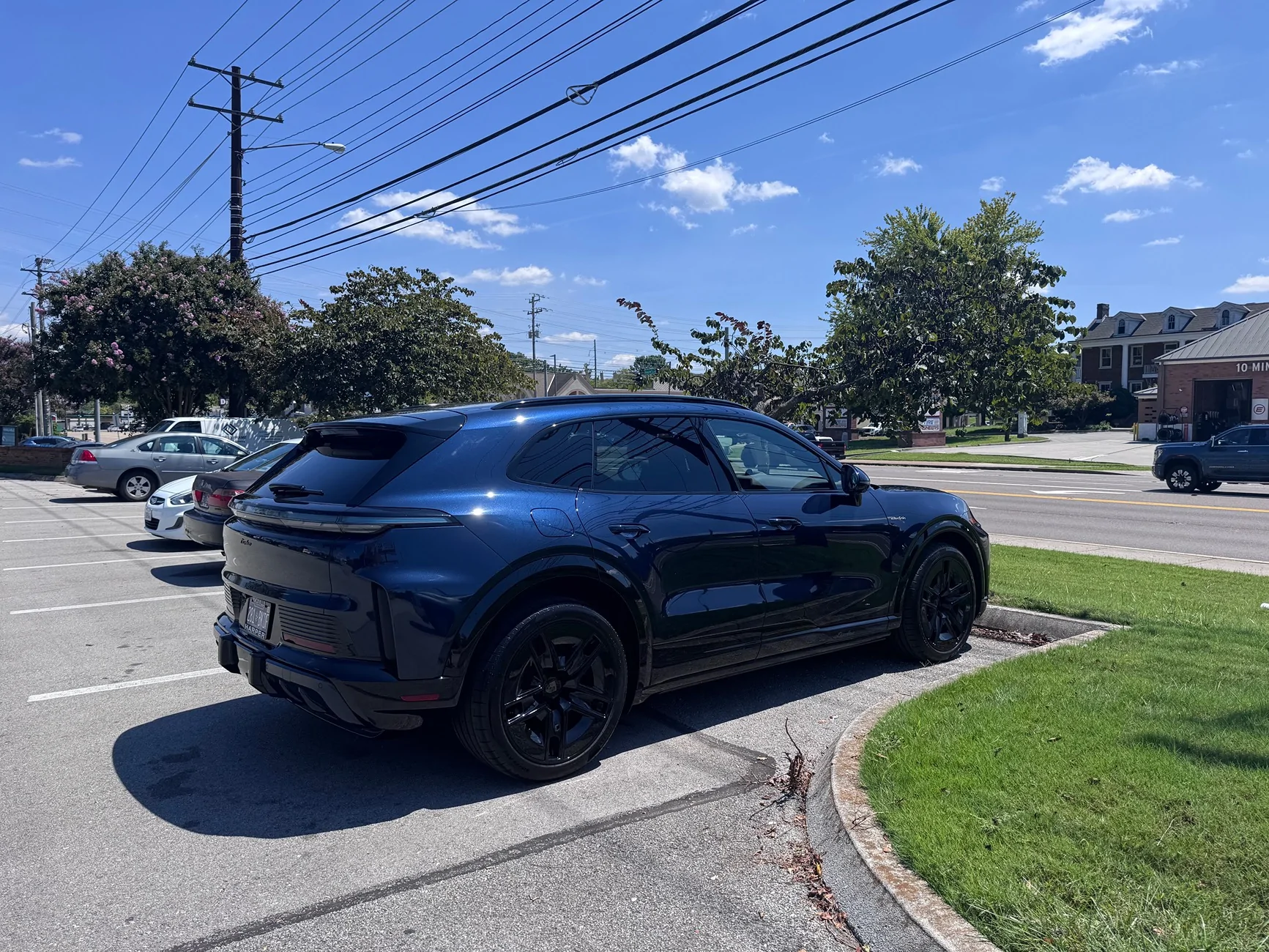

Drove the Turbo home today about 125 miles. Drives amazing, seems pretty efficient, but the Adaptive Cruise decided that it would not work. Just said unavailable, but could drive. All the sensors sem to be reading. I can see the other cars displayed. speed limiter works well to limit it but not to set it to cruise even in that setting. A bit baffling. All tips point to blocked sensors or calibration. Sensors seem fine. Gonna let it sit and see where it is tomorrow.
If any one has any thoughts, please let me know. My Taycan did not have ACC. I got a loaner with it once and it was awful. Got confused by everything, guard rails, etc. I see a lot of posts with issues, seems to be a Porsche thing, every other car I’ve had with ACC has been pretty flawless.
I should say that my delivery was delayed for a week while they tried to calibrate the “Emergency Braking”. I figured that meant the parking brake, but now realize that it’s the system that enables driver assistance including ACC and Emergency braking. They had decided that they were looking at the fault wrong and no cal was necessary, turns out they were likely right the first time and just haven’t figured out how to calibrate it.
Looks like a two hour return trip is going to be necessary. After my Taycan spent 11 weeks there earlier this year, I am losing confidence that the dealer is very competent as to the EVs. I’ve never had the slightest issue with them onnmy ICE cars they’ve dealt with. Of course a whole different level of complexity.

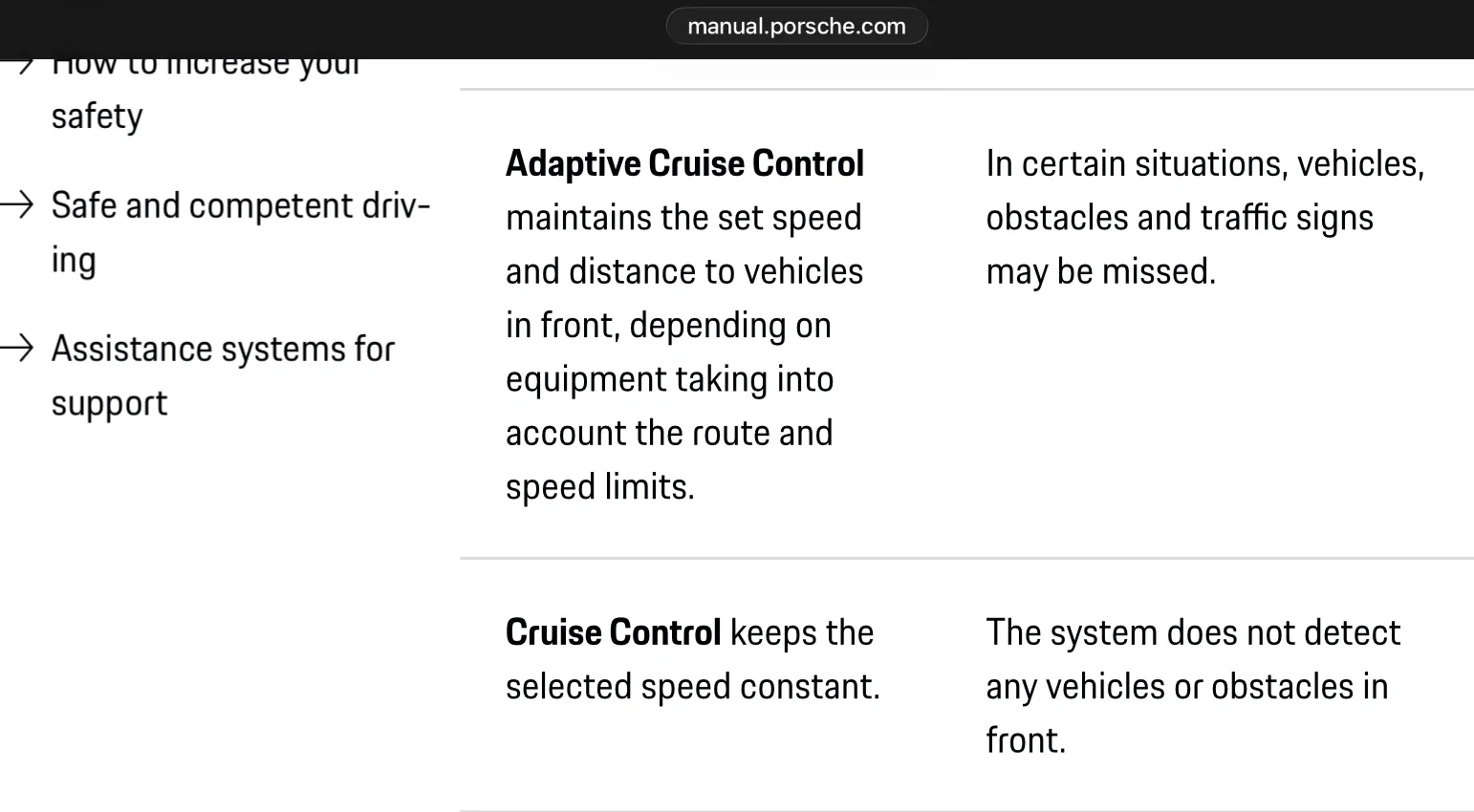

On the Macan you could select Cruise Control or Adaptive Cruise Control by pressing the button on the end of the stalk and then selecting in the left tube. According to the online manual there should be 2 separate choices for plain cruise or adaptive. Apologies if the manual is wrong, I use adaptive and never used cruise control. I have a HUD and so I see the speed dropping, indicate and the car checks it’s safe and pulls out.
