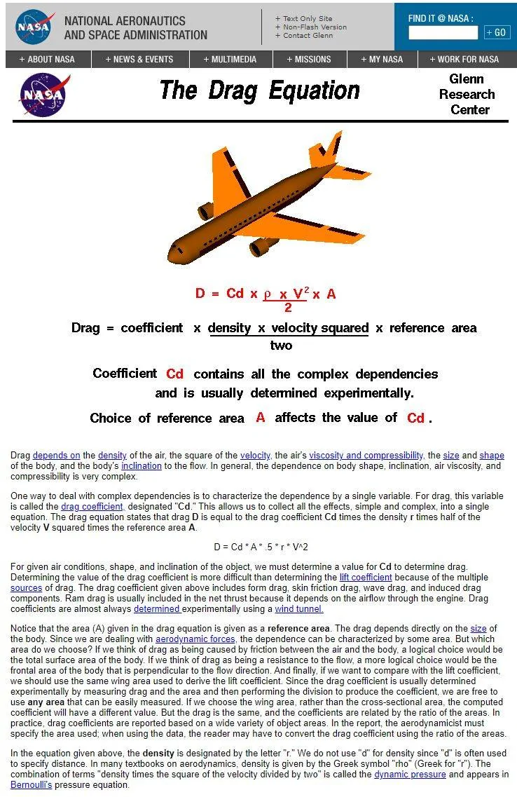

Yes it does. See below, especially the fourth paragraph.
Drag is measured experimentally. Substitute into the equation, rearrange and solve for Cd.
Sorry I wasn’t clear enough.
A reference area is used in the calculation of Cd to make it dimensionless.
On a car (and aeroplane, I believe) the reference area used is the projected frontal plan area.
That means Cd is useless in comparing actual drag of 2 vehicles unless the reference area is known because the drag force is proportinal to both the Cd and the reference area so two vehicles can have the same Cd but very different actual drag and hence overall efficiency.
None of the practical aerodynamicists I know bother to calculate Cd from the data, it isn’t worth bothering with when calculating anything useful.
