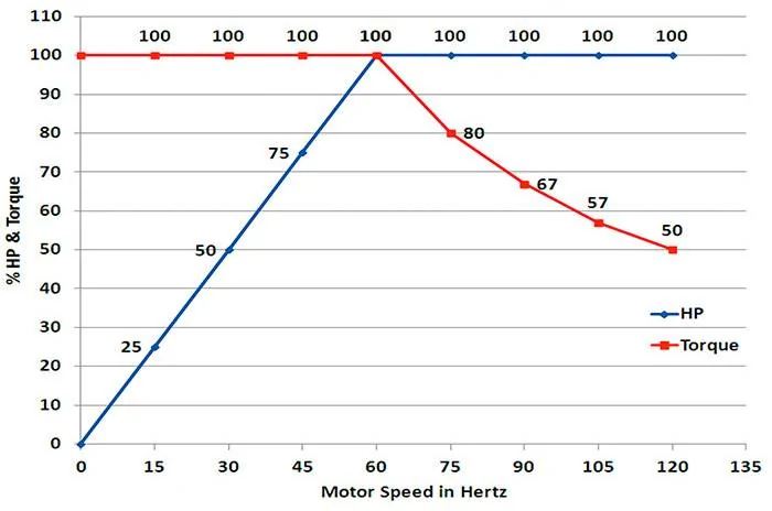

I guess you’ll need to explain this more. Constant HP above base speed is a general characteristic of electric motors.
This is a typical torque/HP curve:
Porsche Cayenne EV Scared to ask... anyone tempted by Model S Plaid? BCE5563A-9CA3-4FBF-A46F-9225053C5D42
Torque is constant up to base speed as HP rises, then HP is constant above base speed as torque drops off.
There are various specialty motors, for example wide HP motors have a low base speed and higher ratio of max speed to base speed by running a higher current at low speeds that tapers off as output voltage rises.
But the above graph is typical.

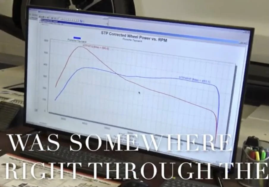

Here’s a screen shot of a dyno from a 4S.
Porsche Cayenne EV Scared to ask... anyone tempted by Model S Plaid? 1311264A-1D99-498B-91D1-902961F164EB
Link:
https://www.google.com/amp/s/insideevs.com/news/485306/porsche-taycan-4s-dyno-teste/amp/
So, this looks kind of how we would expect. The main difference is there are two slopes for torque due to the gearbox.

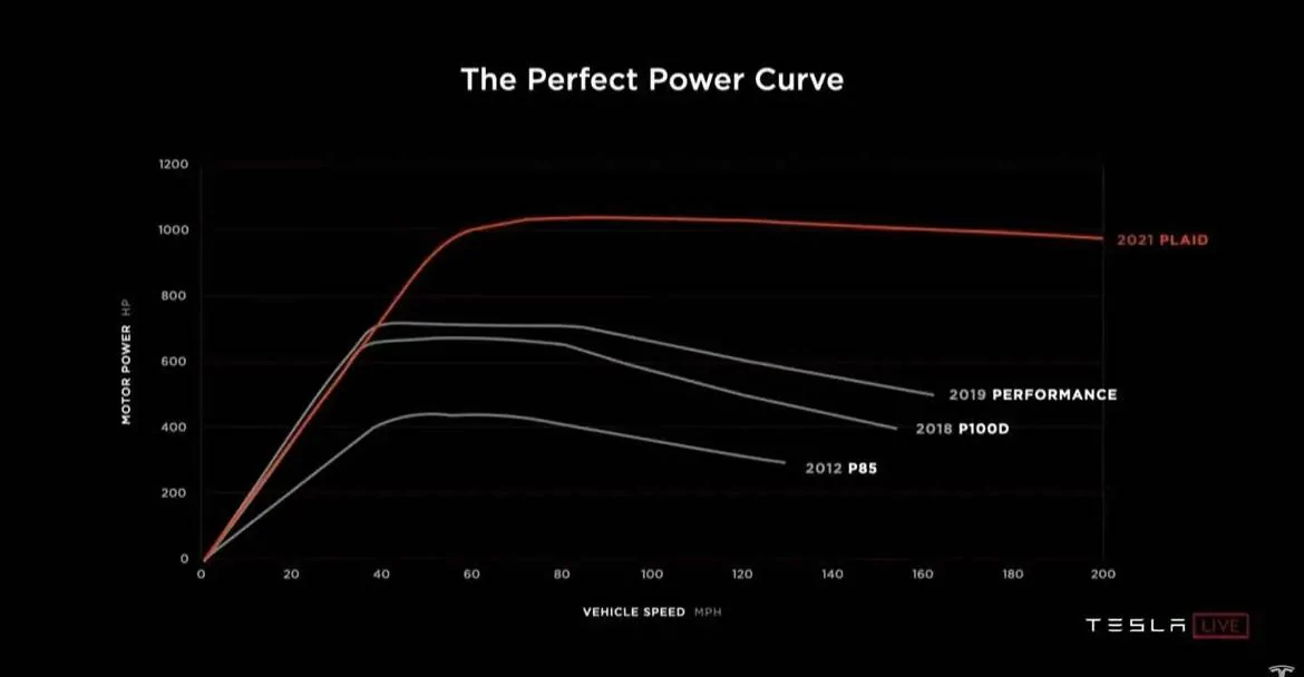

Now, I was curious about this power curve you reference for Tesla, so I looked it up and this is what I found:
Porsche Cayenne EV Scared to ask... anyone tempted by Model S Plaid? F7CC3093-9DEB-4F2E-BD6D-5BF9521EA389
Link:
https://insideevs.com/news/513388/tesla-models-plaid-drive-unit/
So, to me, it looks like the story regarding this power curve isn’t that Tesla leaped forward. It’s that they (at best) caught up (and it still drops off...low bar for “perfect”).
But to claim that Porsche hasn’t “figured this out”? Whatever.
Porsche’s motors appear to produce a flat power curve (at least compared to old Model S) up to max RPM. Best I can tell.
