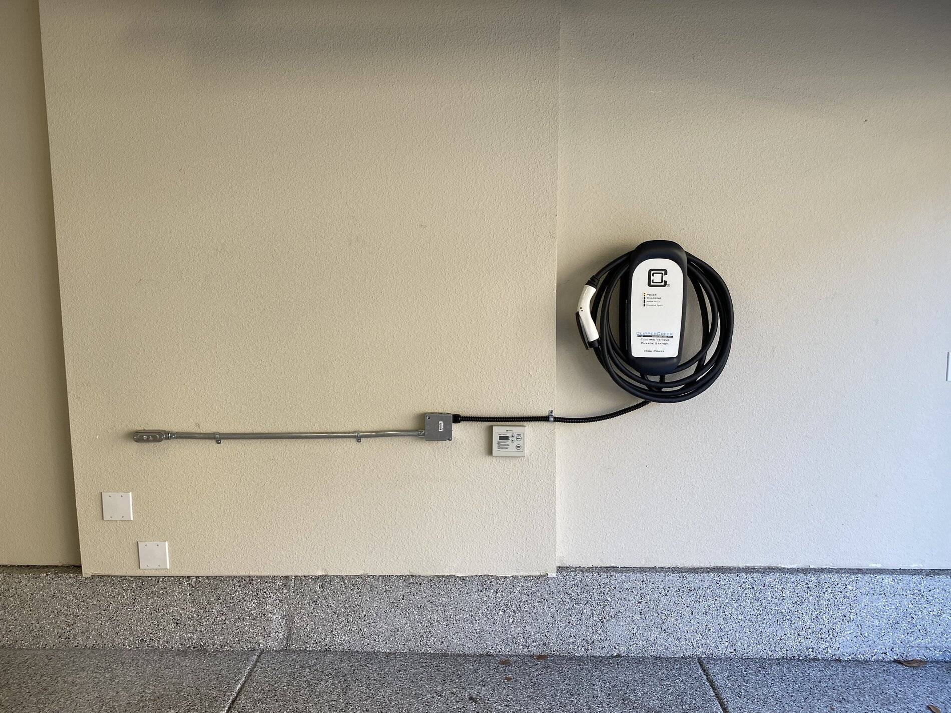

Thanks to this thread I ended up with the right charger for my needs. Didn’t end up clicking the 19.2kw option which actually would have only costed me another $3000 incl the updated charger, but frankly I don’t need those 3-4 hours of quicker charger since my daily use is < 20 miles.
Ended up with the 11kw charging option instead:

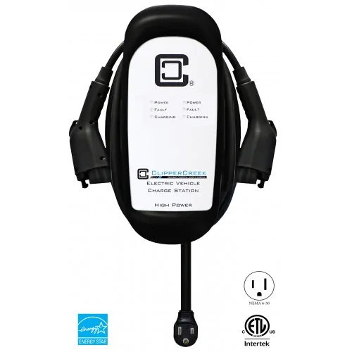

Level 6 - I read Internet forums and I know Porsche is lowballing us with the 9.6 kW specification - my Taycan can actually charge at 11 kW - 240 volts @ 60 amps (48 amps for charging)
(8.5 hours for a full charge from near zero % battery)
it turns out the maximum charge rate for your Taycan is not 9.6 kW, but in fact 11 kW like the rest of the world. However to realize that charge rate you'll have to install a non-Porsche EVSE (no problem 100% confidence in this approach - honestly no big deal) - but the charger will NOT be mobile, it will be hardwired.​
However to realize this you need to have a 60 amp circuit installed and purchase something like a ClipperCreek HCS60 EVSE or Tesla Wall Charger Gen2/Gen3 - this will charge your Taycan at it's true maximum charge rate of ~11 kW - meaning in 4 hours of charging you can pump 44 kWh of raw unbridled power into your battery - leading to a driving range of just over 140 miles range. Your wimp-ass daily roundtrip commute of 52 miles will take a mere 100 minutes of charge time - I laugh at your charge time and think you are too much of a pretty boy to have it this good!!!​
[OCT. 2020 UPDATE] Level 7 - I ordered the 19.2 kW charging option for my MY’2021 Taycan - Porsche missed the memo that even Tesla no longer shipped EV’s witih more than 48 amp L2 charging on board.
ClipperCreek HCS 100 (100 amp breaker) - 19.2 kW of charging goodness!
80 amps of charge rate!!
(6 hours or less for a full charge from 0% battery)​
Congratulations you’ll be able to charge faster than all of us! I’m quite frankly jealous. 19.2 Kw charge rate can charge the Taycan from 0% to 100% in slightly less than 6 hours. Daily commute distances (70 miles or less) will be dispatched in just about 1 hour of charging. This is the maximum specified charge rate available from an L2 (Level 2) North American J-1772 standard. The _ONLY_ way to charge an EV any faster in North America would be to install a FastDC charger costing 10’s of thousands of $$$ and probably requires rare 3-phase commercial electrical feeds.​
My recomendation for this install is the ClipperCreek HCS100 or HCS80 - you’ll need a 100 amp circuit/breaker to achieve the full 19.2 kW charge rate. Consult with your electrician about funding his child’s college education for this installation. The HCS80 w/Share2 functionality is a great choice here but will only charge a 64 amps (15.36 kW) but given it can be shared with a future 2nd EVSE to split the load it’s a great choice.​
