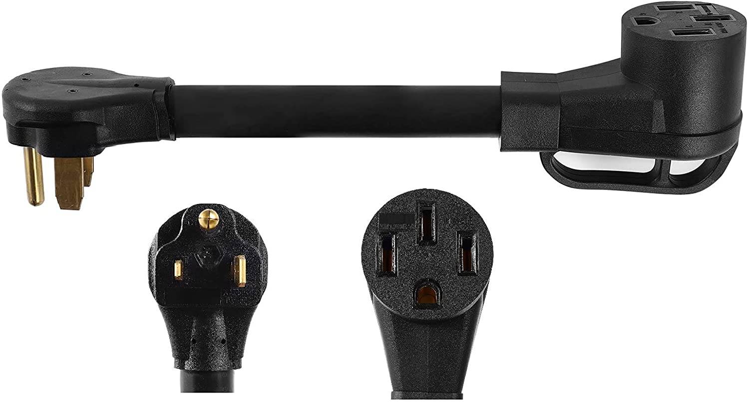

if you do install a 6-50 and want to use your 14-50 EVSE - this adapter should be effective:
Porsche Cayenne EV [US] - Over the Top - the well equipped EV home garage…for those that wish to "over do it"… EB4975CE-1120-4CFE-B28C-9055E9CD3372
ONETAK NEMA 6-50P to 14-50R 240V 50 Amp 3 Prong Male Plug to 50 Amp 4 Prong Female Receptacle Generator Welder Dryer EV Charger Power Cord Adapter Connector
https://smile.amazon.com/ONETAK-Welding-Charger-Connector-Connecter/dp/B07LGLJ26N/ref=sr_1_9?crid=1Y7KN1URJ0HD1&keywords=nema+6-50+to+14-50+adapter&qid=1636901526&qsid=137-6934074-0115537&sprefix=6-50+to+14-50,aps,464&sr=8-9&sres=B088CT4DJ8,B08QVKHT1F,B083LRJ4DP,B088D8WGSN,B07LGLJ26N,B08V16LRG7,B081RGQXMG,B082X57SQW,B07M5CBXJW,B07V7TKZQC,B07QSDM4QN,B08BG67KVX,B07V94TD6P,B07GZBZCYS,B07T2V87K9,B07QVX8YR2,B07THBGGMG,B07TG183HN,B08RBMJJLP,B08P57HQMV
$29
and $29 is way way way cheaper than Porsche charges for the NEMA 6-50 supply cable - if you have a NEMA 6-50 based EVSE and want to use it with a 14-50 plug you encounter while road-tripping - then there is a similar plug to convert the 6-50 to 14-50. For EVSE usage converting between 14-50 and 6-50 plug types is safe and allowed for two reasons:
  1. both are 50 amps - so the AMP rating is the same so no need to adjust the PMC+/PMCC to “pull” different amounts of AMPs
  2. since the Neutral is used by the EVSE there is no problem with the adapters in either direction
you can do the same thing between 14-30 and 6-30 plug types - but obviously you should have your PMC+/PMCC set to the appropriate amps for a 30 amp circuit (24 amp charge rate)
for mobile EVSE usage you can also carry a NEMA 10-50 adapter - but it would be rare to encounter one of these - but again $40 or less adapter can be found on amazon.
