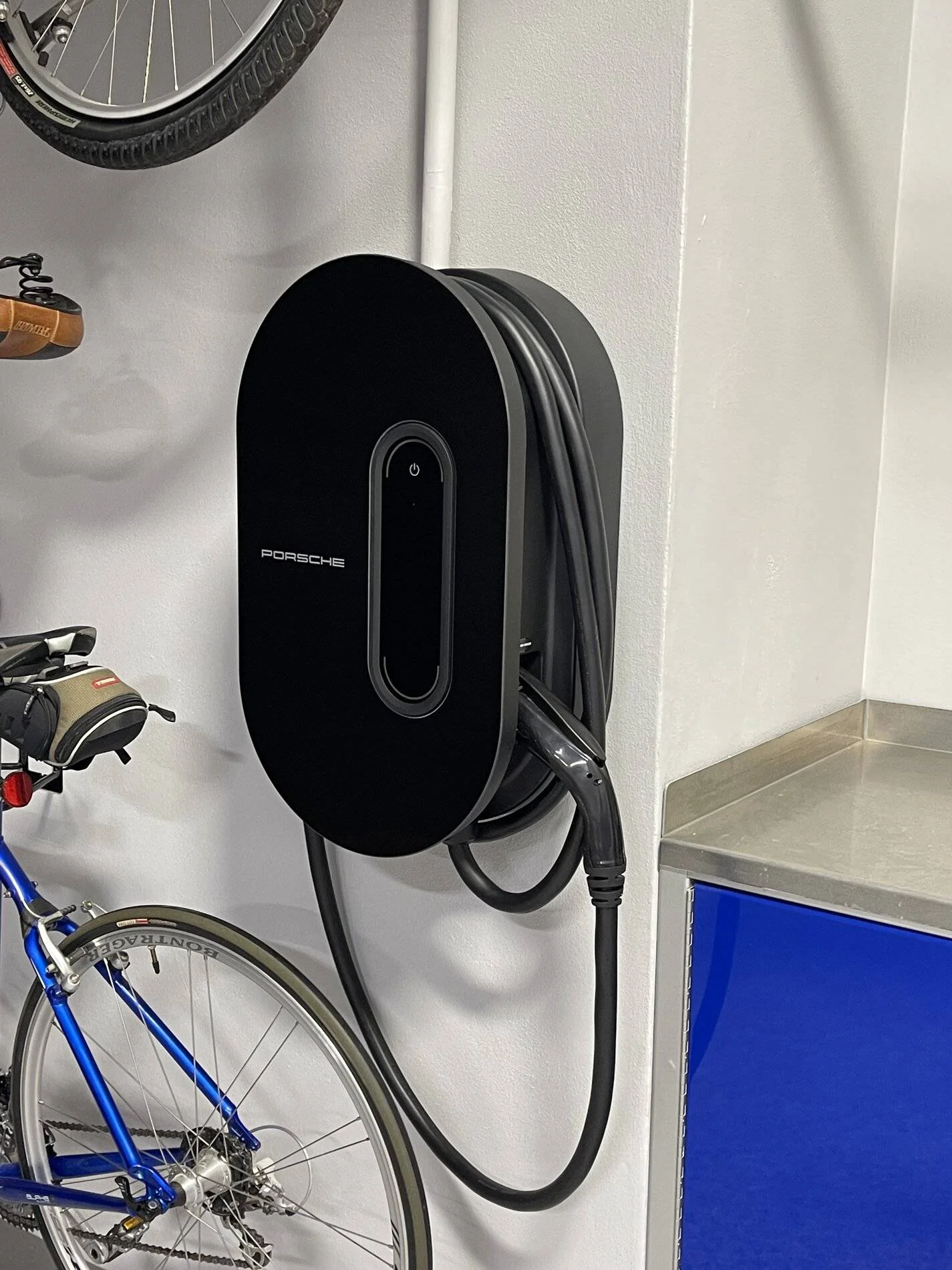

Do you have a TeslaTap adapter yet (allows you to charge your VW or Taycan from a Tesla wall charger). If so, try connecting the Porsche Wall Charger --> Tesla J1772 adapter --> TeslaTap --> VW. Wait 30 seconds or longer before plugging in the car. TeslaTap tricks the charger into thinking there is a car connected, but will not talk any advanced PnC protocol, so the charger might time out and drop down to "dumb SAE J1772" mode (it does that for Tesla chargers), which could deliver 48A to the VW. Just an experiment to try, if you have a handy Tesla Tap (since I assume you have the Tesla J1772 adapter as it comes with every Tesla).I just installed the Porsche Wall Charger (80 amps) to use when my Taycan arrives in a couple of months. In the meantime I’m trying to use it to charge my VW ID.4 which can take 48 A. It will only draw 15.5 A from the charger. The charger will charge my Tesla at 40 amps with no problem. I think the issue is with the communication between the charger and the car. My Tesla wall charger will charge the VW just fine. I sent a message to Porsche but have not heard back. I want to make sure it will work with the Taycan when it arrives. Any thoughts?
Thanks for the suggestion. I was thinking of doing that. I will try it tonight. I do have the Tesla Tap and tesla adapter.Do you have a TeslaTap adapter yet (allows you to charge your VW or Taycan from a Tesla wall charger). If so, try connecting the Porsche Wall Charger --> Tesla J1772 adapter --> TeslaTap --> VW. Wait 30 seconds or longer before plugging in the car. TeslaTap tricks the charger into thinking there is a car connected, but will not talk any advanced PnC protocol, so the charger might time out and drop down to "dumb SAE J1772" mode (it does that for Tesla chargers), which could deliver 48A to the VW. Just an experiment to try, if you have a handy Tesla Tap (since I assume you have the Tesla J1772 adapter as it comes with every Tesla).
Success! The Tesla tap worked perfectly. The PWCC made a successful connection to it after several seconds. Then I plugged it into the VW which began to charge immediately at 48A. The VW doesn’t have the PNC feature which may be the problem communicating with the charger. I hope VW can add it via OTA software updates.Thanks for the suggestion. I was thinking of doing that. I will try it tonight. I do have the Tesla Tap and tesla adapter.
