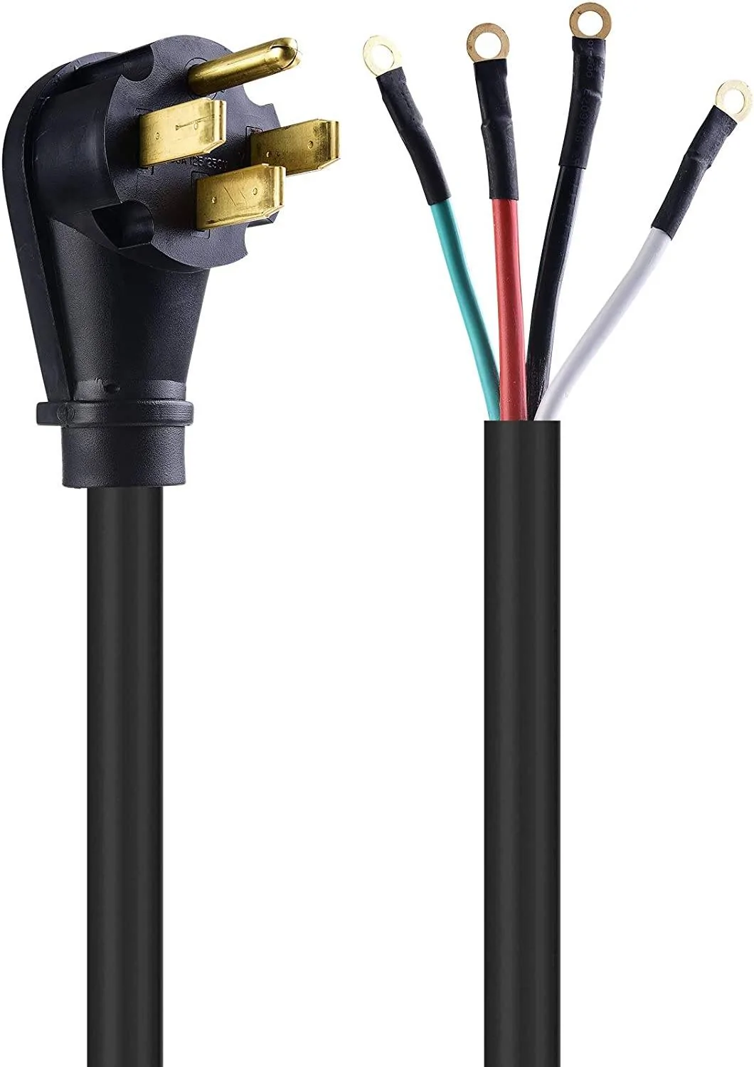

NOTE: this cable from Amazon - routinely achieves operating temperatures of 87-93F in normal multi-hour operation at 9.6 kW (or more) vs. Porsche's supply cable temps of 144F (or more)…the cable listed below has 6 gauge wire for the high voltage 120V legs (red & black wires), and 8 gauge wire for the unused neutral and ground (white & green wires)
93F vs. 144F is pretty damming in terms of where the problem lies - the 93F operating temperature of the $30 cable from amazon will place less accumulated thermal stress on cheaper Leviton NEMA 14-50 sockets - meaning there is less chance the EV charger will induce thermal failure (melted plastic).
we all know what the core problem here is - it's unclear to me why Porsche is not stepping up and distributing replacement power supply cables with an wire gauge that matches their _OWN_ recommendation from the NTSB bulletin - where they require/recommend/demand 6 gauge wire for these types of electrical loads.

In Porsche's OWN tech advisory they recommend the use of 6 gauge wire for 50 amp circuits - but they ship their supply cable with 10 gauge wire…hmmm.
https://smile.amazon.com/gp/product/B07TD9KPKJ/ref=ppx_yo_dt_b_search_asin_title?ie=UTF8&psc=1

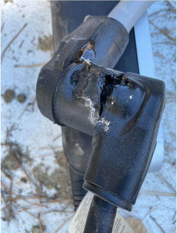

the socket manufactures it's own thermal stress in defiance of the laws of thermodynamics/conservation-of-energy - it's not that Porsche's NEMA male-plug is getting too hot due to trying to shove 9.6 kW of power into a 6 kW wire and then subsequently transferring the massive amounts of heat due to electrical resistance - the plug itself is generating the heat - and in fact might be a power source more powerful than home solar panels…

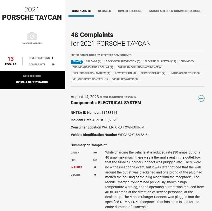

the type of damage caused in this thread…
https://www.taycanforum.com/forum/threads/porsche-mobile-charger-recall.14275/#post-214742
totally 100% th plugs fault - it's self destructing because it can't handle the power/performance of the Taycan - this is not the result of accumulated thermal stress of a poorly designed power supply cable that routinely achieves operating temperatures of 140F (or more) in normal use and overtime causes cheaper Leviton plug sockets to eventual fail when their cheaper plastics subjected to repeated thermal stress causes a structural failure…induced by unnecessary thermal stress.
the plug below self destructed and lost it's will to live because it couldn't handle the awesome power of the Taycan!!!
totally 100% not Porsche's fault that their cable routine achieves operating temperatures of 140F+ in normal operation…
