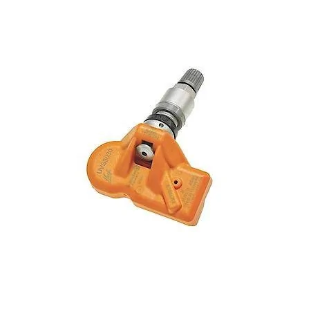

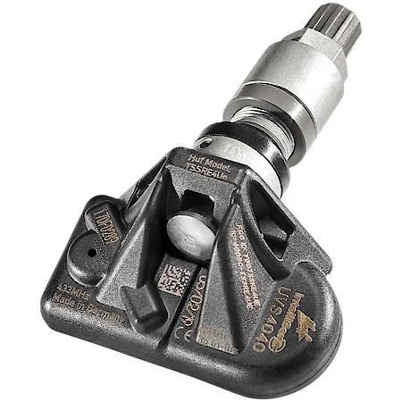

Or you can buy the exact OEM sensor (made by Huf). The sensors are black and you can get silver, black or gunmetal valve stems:
https://www.tpms.com/Porsche-OEM-Huf-TPMS-Sensor-9A790727502-433MHz-p/h0047-porsche.htm
https://www.tpmsdirect.com/Porsche_Macan_TPMS_Sensor_p/9018-08.htm
https://www.tpmsbargains.com/Porsche-Taycan-TPMS-Sensor-p/tpms-9018-ta-01.htm
Porsche Cayenne EV Tire Pressure Sensors (TPMS) - OEM and Aftermarket Resources 1629919995598
Alternatively, you can buy the same sensor in orange (they are a universal but pre-programmed from the factory to the correct 433 mhz), made by Huf (OEM manufacturer). You can also get the silver, black or gunmetal valve stems.
https://www.tpmsbargains.com/Huf-In...rsche-Taycan-p/tpms-9008-09-hufm-0020-tay.htm
https://www.tpmsbargains.com/Huf-In...e-Taycan-TPMS-p/tpms-9018-04-uvc-0020-tay.htm
https://www.tpmsdirect.com/Huf_IntelliSens_TPMS_Sensor_Fits_Porsche_p/rde047-porsche-uvc.htm

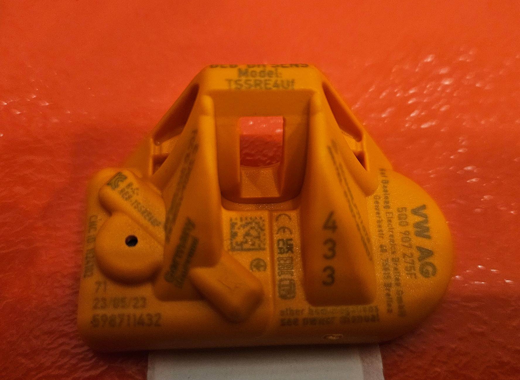

I bought x4 orange Huf TPMS sensors off ebay for my winter setup (I also bought 4 new tires and rims), do I need to do any programming before mounting the tyres, because I wouldn't want to have a horror situation of mounting the tyres on rims and then that the sensors don't work or smth.
I did not have to do any programming.

Hi mate,
I just bought new Mission E's rims, and 4 new M+S Conti tyres, for my winter setup, and I bought 4 orange Huf TPMS sensors (part number:5Q0 907 275F), can you confirm that I can mount the tyres on the rims with these sensors, because I wouldn't want a horror story, with mounted tyres and that the sensors don't work, it would be a nightmare. The pic of the sensor is in addition. Thanks in advance.
