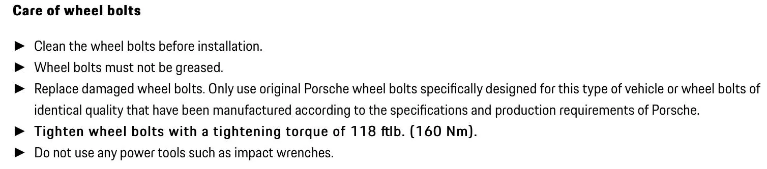

Correction, the 118 is not what they are used to doing. This could be interesting.

Does 'grease' include anti-seize - I would assume so. I didn't realize this was a controversial practice.
Yes, the torque spec is for dry lugnuts. Any form of liquid in there will change the spec.
Chuck J
They should have a chart for reference, but aside from that, you now know it's 118. Same torque spec for other recent Porsche models, so Discount Tire shouldn't have any issue to simply adjust their torque wrench. Assuming you're going for the P-Zeros?
