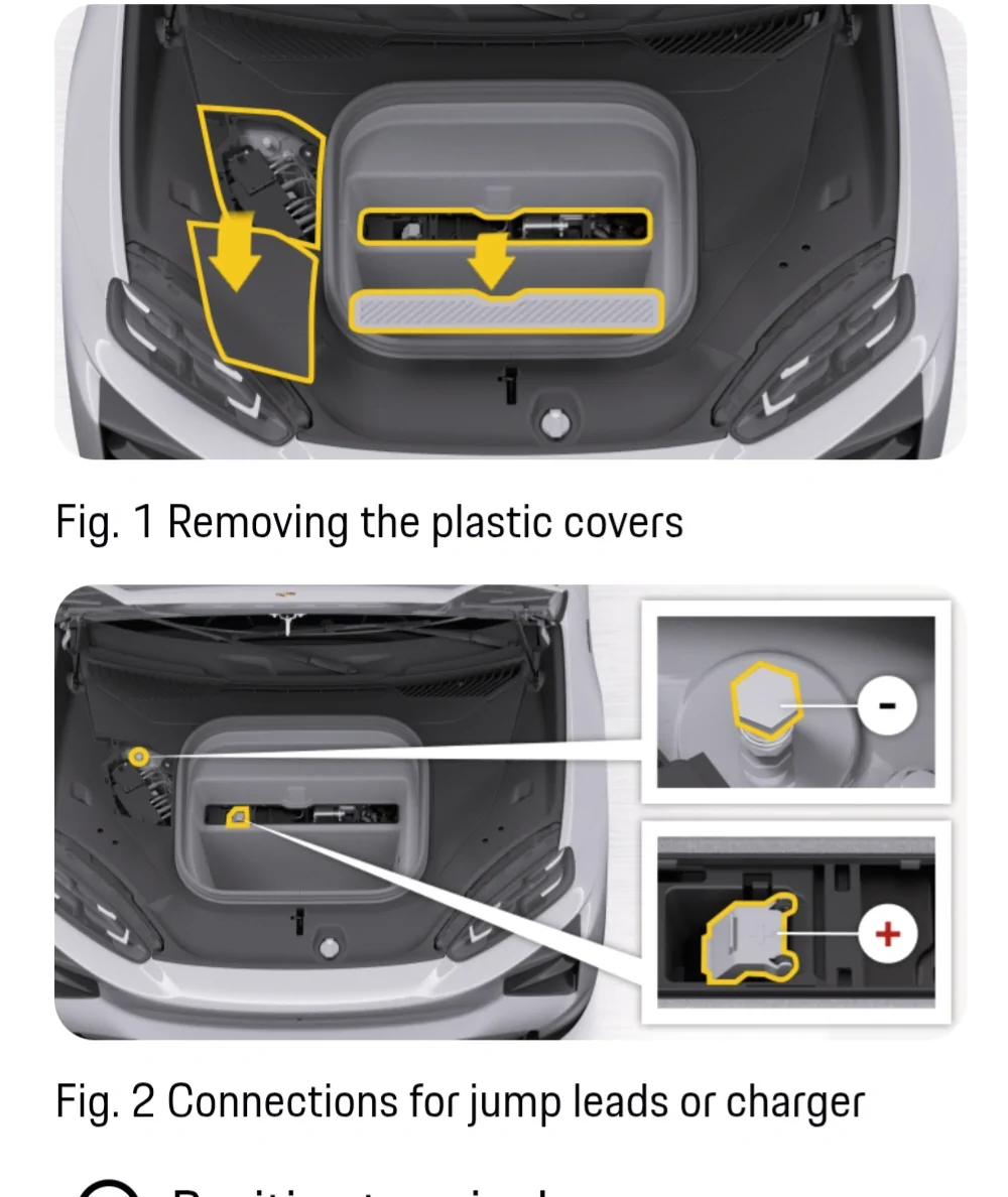

I was curious is anyone know what type of battery we have, AGM or Lithium. Also curious the size of the battery and it's location. Anyone figure out a convenient trickle charging routine?

LiFePO4 12v
Located in front frunk behind a plastic cover.
Get a Porsche trickle charger
Porsche Cayenne EV 12V Battery Type and Location Screenshot_20260916_180822_Chrome Beta

Great to know, thanks for the visual reply
