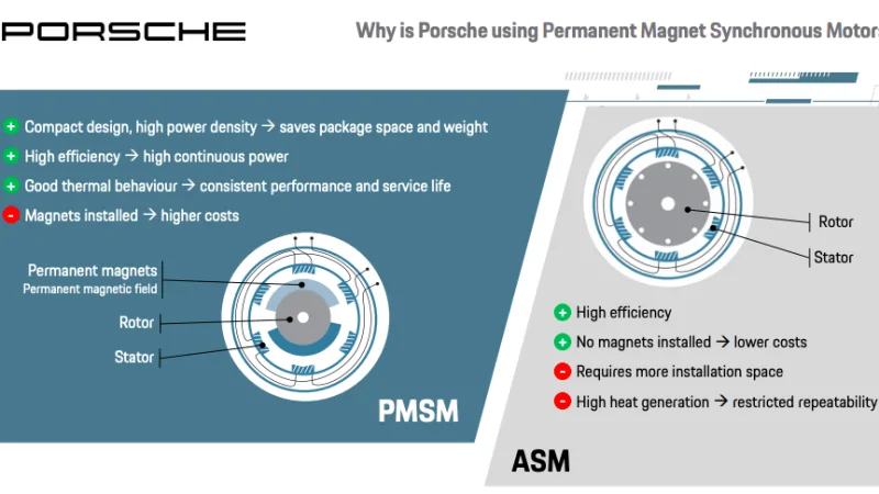

The Porsche designed permanent magnet electric motors run cooler and allow for better cooling as well compared to the asynchronous that Tesla uses:

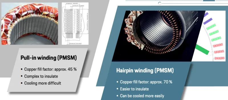

Porsche went with rectangular hairpin winding's on the stators rather than the pull in winding that Tesla uses:

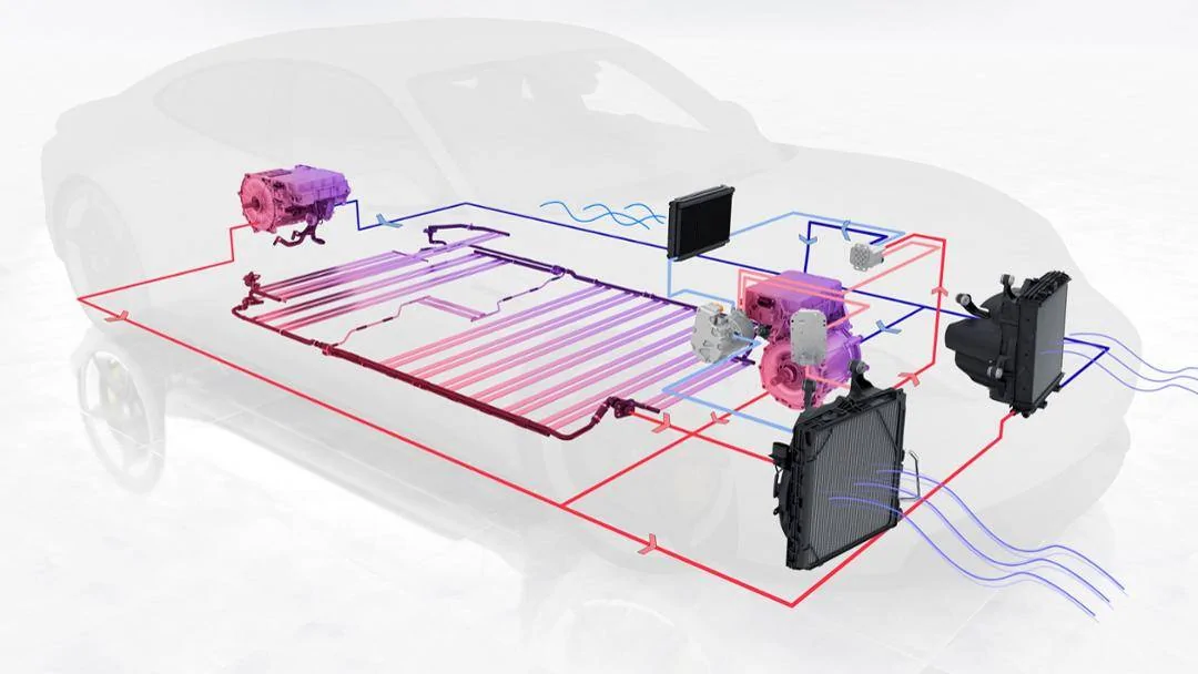

Taycan has more robust liquid cooling design for the battery including dual front air radiators (yet still managed low CoD)
