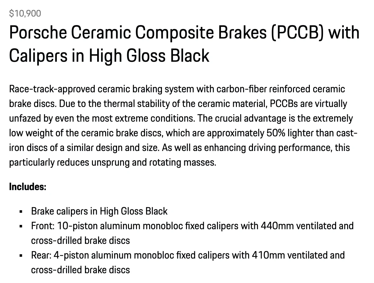

We all know Porsche _LOVES_ their options list and increased margins associated with these mostly excellent choices options. One of Porsche's stand out options for over a decade has been the option to add world class ceramic brakes to their vehicle's - which by any measure are the best brakes mass production money can buy. Now PCCB's have pro's and con's, but at this point in time they are a well sorted choice and the Pro's/Con's are well understood for the well informed buyer.
This option is also one of the most expensive factory options you can add to any Porsche vehicle…

Regenerative braking by Porsche's own admission handles 97% of your Cayenne's normal use and therefore the friction brakes are far far less used on any decent EV…3% or less of the time by Porsche's own data and claims!
PCCB's 3 main super powers over Porsche's excellent cast-iron metal brakes are:
I believe this is an excellent place to save money on a Porsche build for an EV…and will never be missed…and you also avoid the cost of repair/replacement should that come up for some reason (PCCB's are with out a doubt deeply expensive to replace/repair should it be required) - it can easily and nominally run more than $30k to repair/replace all 4 PCCB's rotors on any of Porsche's PCCB vehicle's. PCCB's are not fragile, but they are less resilient to certain types of road hazards than normal cast-iron brake rotors and should them become damaged or compromised they are simply expensive to replace. They may in fact be a terrible choice for an SUV that actually will used used on gravel/dirt/poorly-maintined roads…it's worth considering where/how you intend to using your Cayenne EV before checking the PCCB box.
- lower weight
- lower dust emissions for cleaner wheels
- thermal endurance under heavy use (never fade)
- weight always matters - but I'll argue on a 6,000 lbs vehicle - you've already lost - so this $11k+ option isn't going to be that much a "win"
- low dust - still true, but doesn't matter if the friction brakes are never/rarely used
- on an EV with excellent regeneration friction brakes are rarely used and wear even less - no dust if there is no actual wear…
- thermal endurance - this one is counter intutitive - but again - regeneration means the friction brakes are not used and therefore do not thermally "heat up" in nearly any scenario for normal driving
- where you would need thermal endurance is for track or very very spirited driving over long periods of time - but even in that case because of consumption and other limitations you run out of "capacity" in other components (battery thermals and actual total capacity) of an EV before you're going to thermally saturate the friction brakes…
- based my actual track experience with my 2020 Taycan Turbo - you simply can not drive an EV hard enough and/or long enough to need high-endurance brakes…you can't be on track long enough to "need" high endurance brakes
