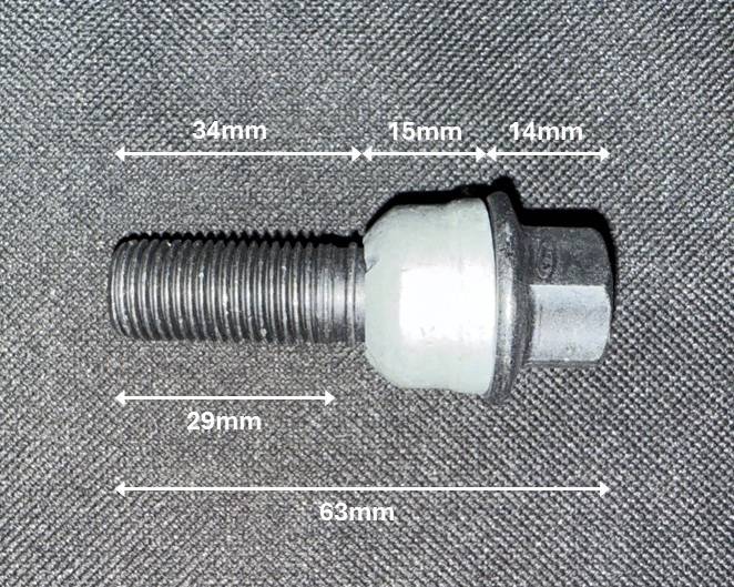

Despite searching online, I had trouble finding baseline length specs for the OEM wheel bolts for my 2023 Taycan.
Hopefully the information below will help someone considering spacers, etc.
This is the bolt that was introduced in October 2022 for the 2023+ models.
This bolt has a 17mm head (not 19mm as in earlier version).
The older wheel bolt is part number WHT-004-676-A for prior models, sorry don't have that one to measure.
Part No: WHT-010-066
2023+ Taycans
M14 x 1.5
17mm socket
Total bolt length: 63mm
Head to bottom of collar: 14mm
Ball seat: 15mm
Shank length (below bottom of ball seat to tip): 34mm
True threaded length ~29mm
